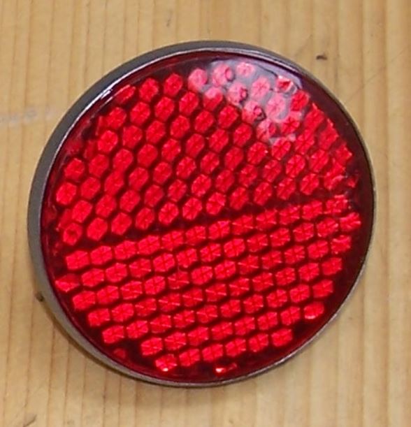

@ @ nieuwenhuis,
Girandole = Helix
Catarifrangenti =
58,45 KB
Bye

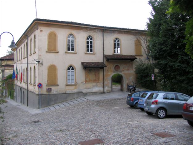

@ nieuwenhuis,
Ok, so the third road is made in asphalt or another kind of pavement like little stones?
I'm aksing this because its unusual to see a third road larger than the main street.
Does your intentions are to build something like this?
56,75 KB
I took the photo from here:
https://www.google.it/search?q=foto+cas ... B500%3B307
Castiglione Olona is very nice and close to my home. Feel free to find some inspiration if you whish.
:grin:
Bye
